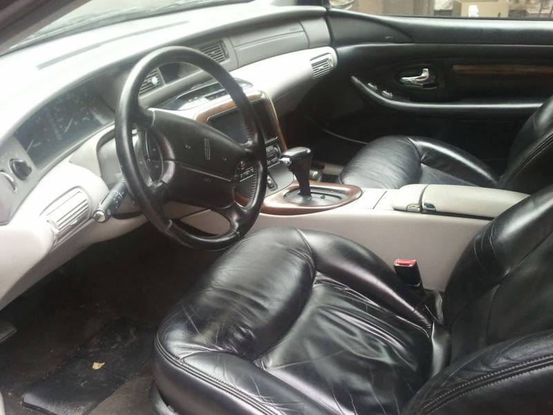

Grabbed a couple real quick.
Still have yet to paint the housing behind the steering wheel and the lower dash vents black.
Careful, that plate right above the steering wheel is screwed in...you have to drop the column to get to the screws (so don't tug on it ) :)
