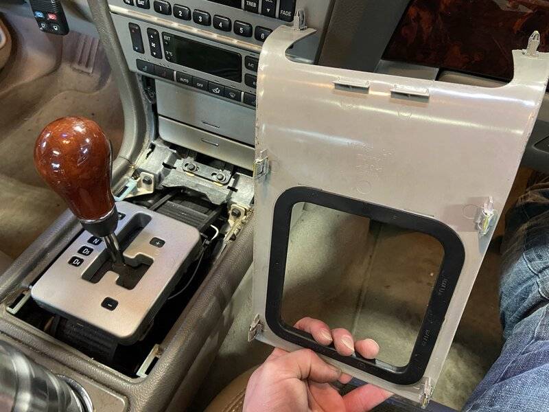

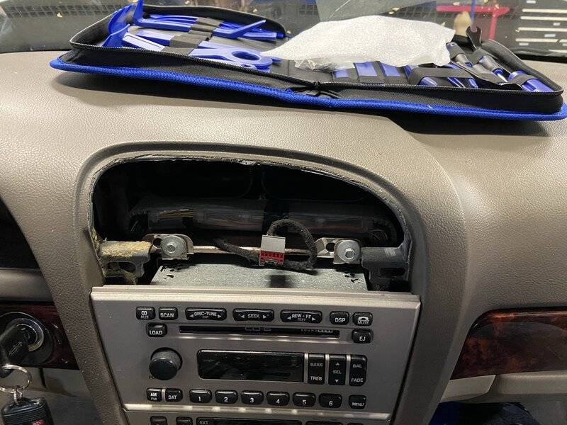

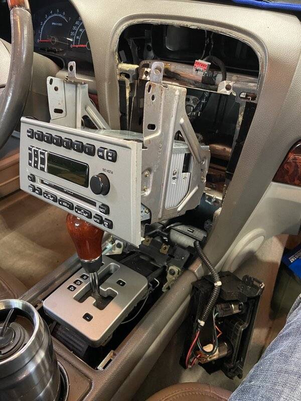

          Back to my original post...
          Need just a plastic pry bar, phillips screw driver, 7mm, 8mm sockets to get the bracket that holds the stereo and DATC in/out. Now she blows again!
