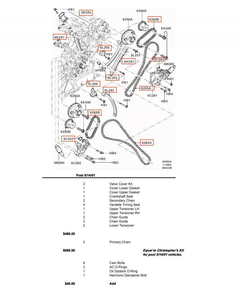

I don't plan on going into business with this, but if anyone wants the same "kit" for the post 5/14/01 vehicles that I just bought from my Ford Dealer I'll get you another one at my price. PayPal would add 0.035% and $12.85 for shipping. I'd take USPS MO if you don't want to pay the PayPal fee.
My Ford/Lincoln dealer mechanics said it's rare for the updated Primary Chains to be an issue so I'm giving those as an option, as well as parts you would need that are not included in the on-line "Kit". Ford states in the manual that the cam and crank bolts are to be replaced.
My eBay ID is Jack*s-Garage and Audiogon is fmtrvt for reference. I'm only going to do one or two of these as I'm not making a dime on this. It will take the dealer 2-3 days to get all the parts in before I can ship.
can you get just the secondary "kit" any cheaper than Christophers Secondary Chains?
If you're going to replace the secondary chains with the Ford unbroken chain, you are going to have to pull down the front cover so you can remove both sprockets. Then you're all the way in and might as well do all the potential problem parts.
If you're just going to do the upper tensioners on a post 5/14/01 vehicle, if you are willing to unbolt the exhaust sprocket only, or loosen the exhaust cam to lift the chain out of the way, then you only need the VC gasket kit and the upper tensioners. (2 VC Kits, 2 Upper Tensioners: $196 + fee + SH; 2 exhaust cam bolts add $7). Pre 5/14/01 you also need longer upper tensioner bolts (add $3) and the cam bolts are more expensive (add $10 instead of $7).
You will need to rent / buy the tools to hold the exhaust cam sprocket and cam while you do the torque / 90° rotation of the cam bolt if the sprocket is removed (best method). Unbolting and lifting the cam has been done, but there is one report on this forum and another on the Jag forum where the cam was broken while carefully tightening it back down with the cam flats up. It sounds like it can be done better if the exhaust cam is rotated so the valves are at their least amount of combined lift (flats still in sync, just not parallel to the VC gasket surface), but that's more risk then I'm willing to take.
