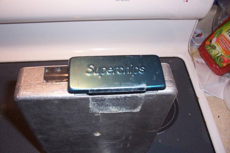

I just want to put this out there. I got Ice and have put 1000 miles on her and no overheating. Only problem that bugged me was stalling/dieing out. I would be at stop light and car would like stumble and die. It would start right back up. It would also hiccup as soon as you would punch it and while cruzing it would hiccup. Not alot but 3-4 times a ride. I thought it might have been from the COP conversion but was thinking chip. I bought car that was suppose to have a "Jerry" chip. I found this. I was like WTF a "superchip" eck.
I pulled the 95 comp and put in a spare 93 without any chips. No more stalling but runs hotter. Mid gauge nothing crazy.
Then I pulled my other 93 comp with a Diablo chip and no stalling and runs cooler. (oh course with new fan schedule)

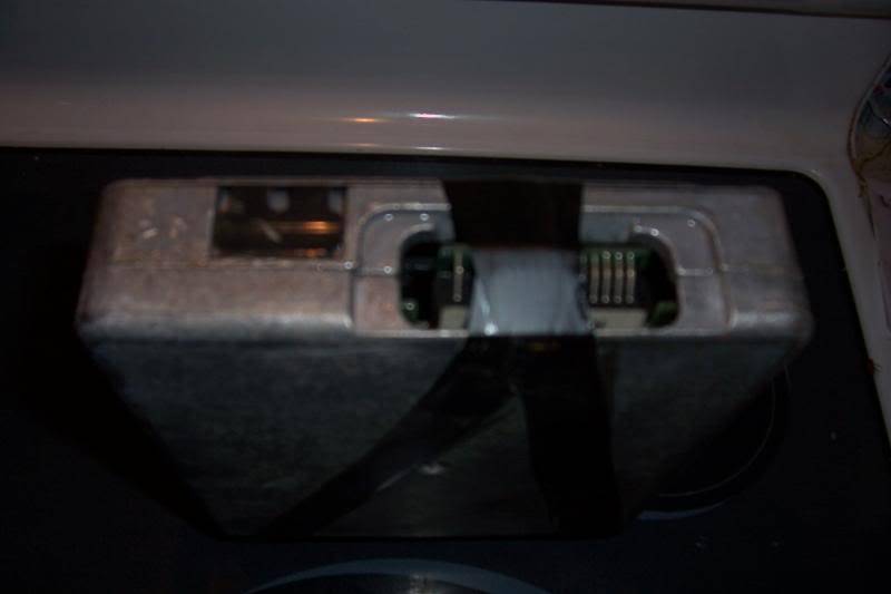

I will pull chip and put stock comp back in and see how she runs. I just might have to clean the comp chip contacts. This Superchip was bought in 2002 I bet.

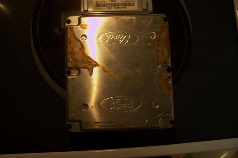

I wonder if there was any corrosion on the contacts..I remember seeing pics of that car with a bunch of mold buildup on the seats..looks like it sat in a non climate controlled garage for 10 years, constantly fogging up the interior and getting moisture inside.
