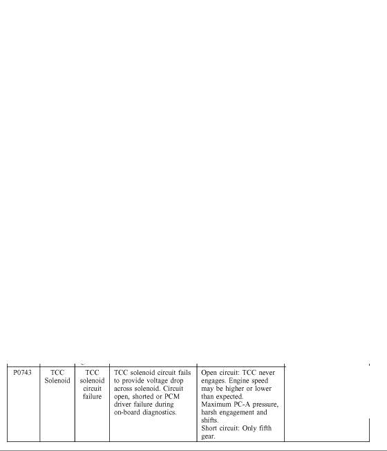

P0743 Torque converter clutch circuit electrical
I am not getting any of the problems with the occuring code at all. The car runs and drives great, like nothing at all is happeneing.
I want to take it to a shop, but I dont want them to try and sell me a rebuild or anything expensive when it could be something small.
