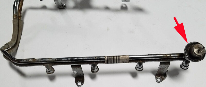

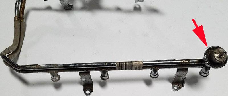

yes the fuel pressure regulator is on the driver's side fuel rail. The fuel pressure pulse damper is on the passenger rail up near the front. the cup is part of the fuel rail & the damper itself fits into the cup w/ an internal snapring. I sourced a used one from racebronco2 via ebay & even he was unaware it was a theoretically serviceable part. Still for piece of mind would i like to be able to source a new alternate if anyone knew of interchange
I attached a pic I found on internet. Does the arrow point at part you seek? I am unable to work on my car so I've never laid eyes on the fuel rail. Ford parts list the fuel rail as a manifold.
