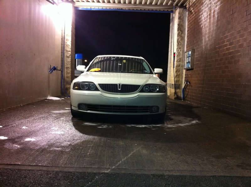

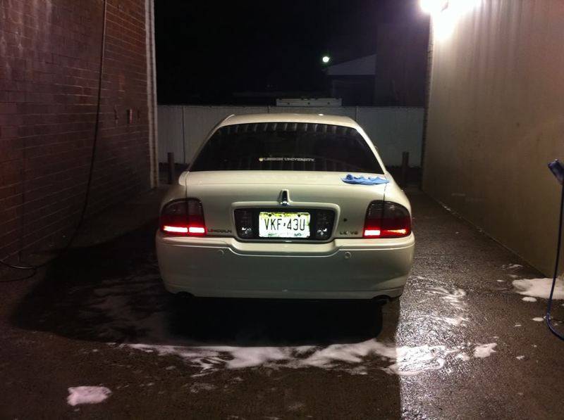

Look what i did this weekend:
Color-matched rear surround and stock grille.
Not a perfect match, but not bad for being my first time. Came out a bit darker than it should. I followed the directions from LSK. 2 wet coats.
The match surrounds look great! Sorry I can't help you with the charging problem.
Color matched is so sexy! Blacked out lower grille and you're set.
Yay, nay?
Wow that looks much better. How about one with the whole thing in black? Lol if its not too much to ask.
Lol my bad poor wording on my part. No, the bottom grille, blacked out all the way to the fogs. I dont know how to explain it lol

I actually did my lower grille like pektel did his. I like it better than way than painting the edge where it meet the fog. Someone else had theirs painted all the way and I looked at pektel's and liked his better, seemed to be cleaner.
I like it because it looks like it could've come from the factory that way.
Lookin' good mlara ;) Can't wait to color-match my lips and grille!
