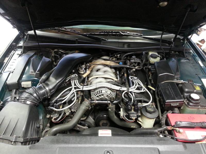

Got the plugs and wires on..did a little clean up with some wd40 and lots of scrubbing. Props to Joe (stang1) for the amputated intake tube. Nothing too exciting but at least its cleaned up..no more useless engine cover.
Before
After
Kevin, you can cut off that loom that runs across the intake and replace it. Very cheap and easy. Makes a huge difference visually and fresh loom will protect the wires better than the old crusty stuff. Also the cross-over fuel hoses with fuel line clamps :)

K, did you pressure wash it? what all did you cover before spraying? coil packs and alt?
Sapper ya I thought about cutting off that white tape and putting something else on it but didn't have any tape that would hold up against the heat, plus I just wanted to get it done and buttoned back up so I could take it to the local car show..that can be another days project.
As for cleaning it I went with sapper's suggestion and sprayed some wd40 on some of the caked on dirt and grime and let it sit for a bit, wiped it off and repeated..didn't hose anything off other than the front of the motor to get the wd40 off the belt and the exhaust manifolds so it wouldn't smoke and burn off. I know people who've pressure washed a mark engine and not had a problem but I'm kinda weary about it with all the electronics on this engine and how finicky they can be.
Any loom will work, but use a name brand electrical tape to wrap the ends.. cheap tape is what it is
How'd the WD40 work for ya? From the pics it looks like the timing cover came fairly clean
If you decide to use a pressure washer, just do the foil wrap on coils and other electricals. Having an air compressor helps to blow out.connectors and just plug them back in if they get wet. Try not to hit the tops of the valve covers to avoid water from getting in the plug wells and cause misfiring
