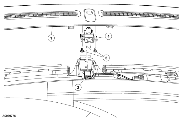

Sep 12, 2023 #1 J jm_03_ls New LVC Member Joined Sep 12, 2023 Messages 2 Reaction score 0 Location Morrisville, PA I'm replacing my auto light sun load sensor and am not sure how to do it. Has anyone replaced this? Any help is much appreciated.
Sep 13, 2023 #2 joegr Dedicated LVC Member Joined Dec 10, 2005 Messages 21,603 Reaction score 2,392 Location Gulfport 2006 Lincoln LS Workshop Manual Removal and Installation Remove the LH and RH windshield side garnish mouldings. For additional information, refer to Section 501-05. Remove the instrument panel defroster grille. Disconnect the electrical connector. Remove the 2 screws and the light sensor. To install, reverse the removal procedure.
