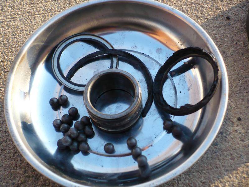

So I noticed that clutch plate was bad on the 97 and needed to be replaced, after removing it, I noticed that the bearings were going to go sometime soon and decided to just replace the whole clutch assembly.

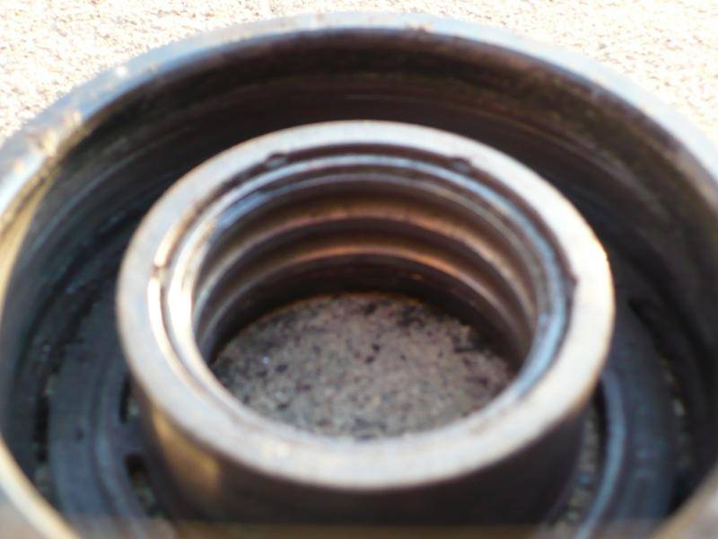

The front bearing seal was gone on mine as well, that's why I decided to replace it as quickly as I did.
