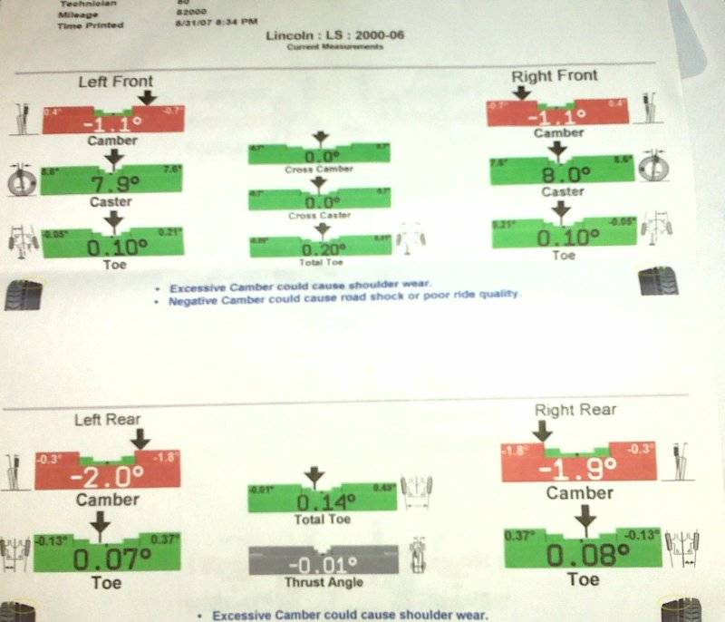

I believe so and if not, it was as close as it was gonna get. I'll see if I can find the sheet when I get home later.
Not used here...didnt need them to be 100% within factory specs...
Yeah, just camber. Like I said, it's been aligned since then, so I'm not sure if it's dead on or not. I can't remember and don't have the print out. We were kind of pressed for time when we did it the first time, since we had to put the cam bolts in first. As long as it was close, I was fine with it.
