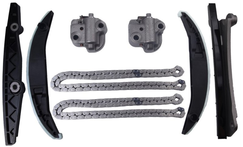

Here is a pretty good set with the guides you need. These are used on Jaguar, Mazda and Ford vehicles so are common items. I see dozens of kits on EBay.
Jaguar 3.0L Timing Set

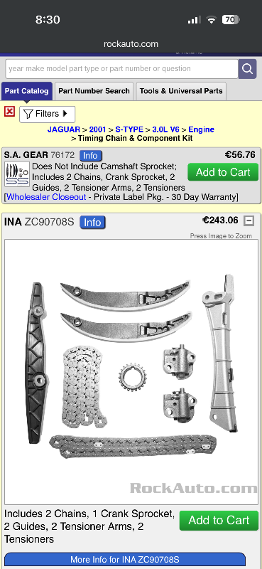

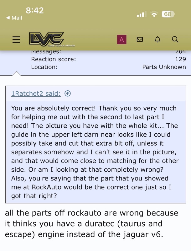

i think this set it's not the correct one, its the same as rockauto , it doesn't fit to jaguar engine, i order it before 1-2 months.
It's the same engine? Can you post what was wrong?
