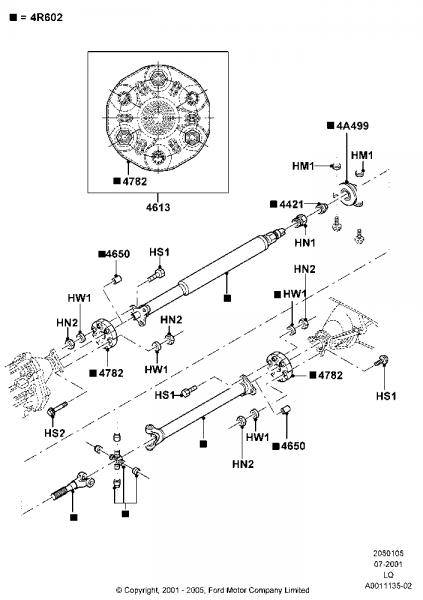

    Looks like these? Tell the dealer you want the propeller shaft center bearing.
  7. bschooled
    bschooled Active LVC Member
    Messages:
    63
    Likes Received:
    Joined:
    Aug 31, 2011
    Location:
    Hancock
    Yes! Thank you, I couldn't really figure out what it was called or what it would look like. The dealer should have this?

    I just called my local dealership. The parts manager is a buddy of mine. He said that the part is still available, and is specific to the LS only. This is the carrier assembly, which is the horseshoe bracket, rubber, and bearing. The part number has been superceded with XW4Z-4800-CA. My discounted price was $115 OTD. I ordered one as a spare, and will have it by Monday. Mine doesn't need it right now, but I got one anyway, because somehow, I think there will suddenly be a run on this part. :shifty::shifty::shifty:
    Another symptom of the carrier bearing is a driveline vibration between 40-50 mph in colder winter temps. The issue is not the bearing itself, but the rubber breaking down. It would be nice if someone came up with a urethane replacement piece for this, as the bearing is/was available separate in the aftermarket.

    bschooled: is the part number above (XW4Z-4800-CA) the same as you bought?
