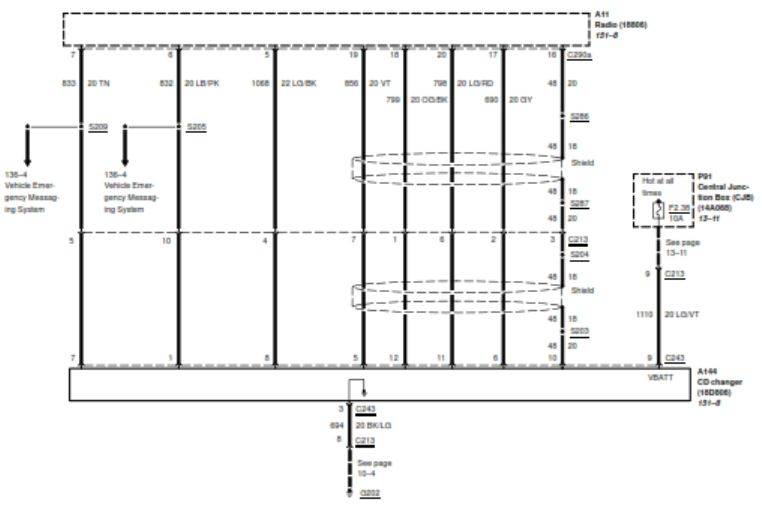

I have no idea what you are trying to do as I’m not a big audio person.
I attached the radio wiring diagrams in case you don’t have them.
