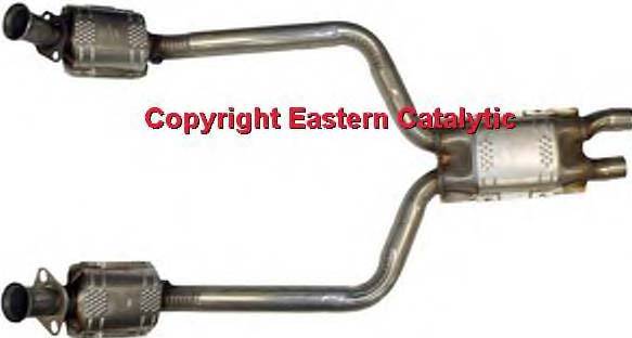

I had to replace both cats last year on my 2005 LS 3.0. The cost of OEM cats are over 900 a side. A universal cat will not work due to the slope of the firewall and exhaust configuration. The aftermarket cats have to be for the LS; if a "universal" non type specific has come out since last April that will work I am unaware of it. I could not find any cats manufactured for the v6 other than OEM. I ended up replacing both cats with an aftermarket set for the v8 at a cost of about 350 plus shipping and have had no problems. It arrived as one unit from the exhaust flanges back through the cats and H pipe(which I removed and replaced with a magnaflow X) The only mod I had to do was move the left rear O2 sensor as it was hitting the oil filter.The company name was Eastern Cat and I found them on EBay. Good Luck
This is a picture of the cats I got from Eastern and their web site.
http://www.EASTERNCATALYTIC.COM/
