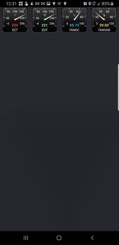

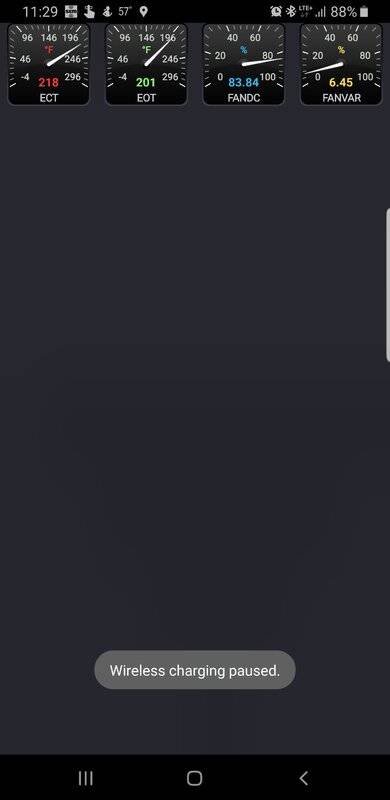

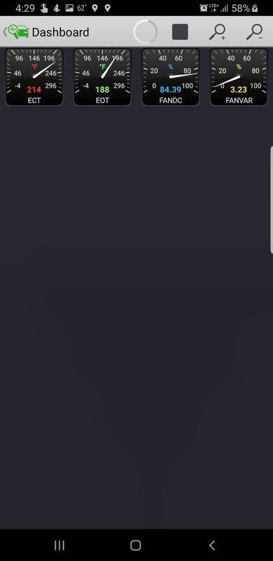

I consider it overheating but I guess the car doesn't, it doesn't turn the fan on over 6 % till it hits 220 degrees on the coolant, is that normal? I'd like to see it run closer to 200.

Just replaced my thermostat and plastic shit it's in and down tube with motorcraft, was new but aftermarket before, no change with the motorcraft parts. AC doesn't work, but when i turn it on the fan only goes 16 precent, better than the normal zero percent at 200 degrees i guess, ha
If you're giving the temperature at idle (car not moving), and your AC is not working, I'd say that your temperatures are normal.

Didn't seem to matter if moving or stopped. It kicks the fan on 3 percent at 212 and 6 precent at 216, that's normal or you're saying the ac not working is affecting fan speed? Makes no sense to me.
That's normal. If the AC were working and on, it would have to speed the fan up some to keep the AC from going over pressure. So, running the AC forces it to over cool the engine a little. Without the AC, it is free to run the fan the way it really wants to (slower). Note that some other cars use an electrically controlled thermostat so that they can force the engine to a warmer temperature when they want to, even if the AC is running.

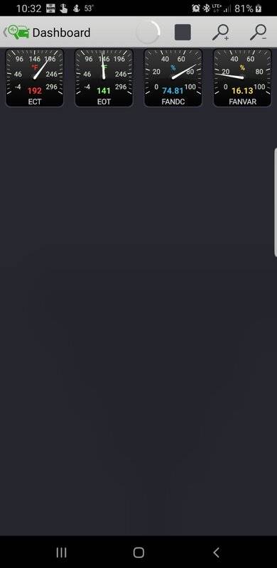

Ok, now this one is just now, no ac on, but it's acting more like i would expect it to. Only difference is that i had the heat on manual and blowing more now, previously was on Auto. But notice the fan is running much faster at a much cooler temp than before. Strange. I don't get it.

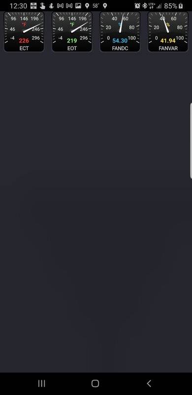

Well as you can see at 226 my fan is running less than half speed, it should be 100 percent at that temp if 230 is overheating. I bought this car about a year ago, it's a 2003. I've replaced the entire cooling system already except block and heater cores and hoses going to the core, heat works great, still running hot\fluctuating greatly, however looking at the forscan info is clearly because the computer isn't running the fan correctly, or it has different triggers then i assume. Notice my last picture, it appears to be working correctly and the only difference is the heat is on manual and in the first ones it's on Auto, I'll do more testing today, maybe that's the answer. Otherwise I don't understand why the fan is so sporadic. I expect consistent results. About ready to hotwire it to a potentiometer and run it inside so I can control the fan manually. That will fix it, ha!

Well as you can see at 226 my fan is running less than half speed, it should be 100 percent at that temp if 230 is overheating. ....
It's not supposed to be 100% till 236 or so!
It is running it correctly, you just don't understand what correct is in this case. Note that it will pick different temperatures based on conditions and predicted conditions. If this is driving you crazy, you'd never be able to handle BMW with the electronically controlled thermostat. (Other brands do that now too, including my car.)
