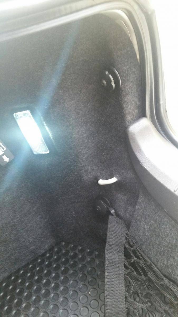

I have a 2006 Lincoln LS with the factory cargo net that I have never got around to installing. In the owners manual it states there are six anchor locations in the trunk of which I can find zero. Per a few threads I found the anchors may be in an accessory package that I will see if I can locate in my garage or spare tire area. If not pre-installed does anyone know where the OEM trunk mounting locations should be and is any drilling required? A Pic or two would be helpful.

No drilling required, unless you have THX nav. In that case you are out of luck since the four-channel amp prevents the use of one of the four anchor points. I put the one that came (uninstalled) in my 06 in my 04 because of this.

The four-channel amp is on the driver's side. I don't remember if the missing one was upper or lower. I'll have to look.

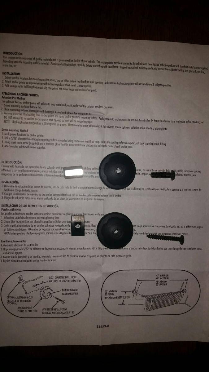

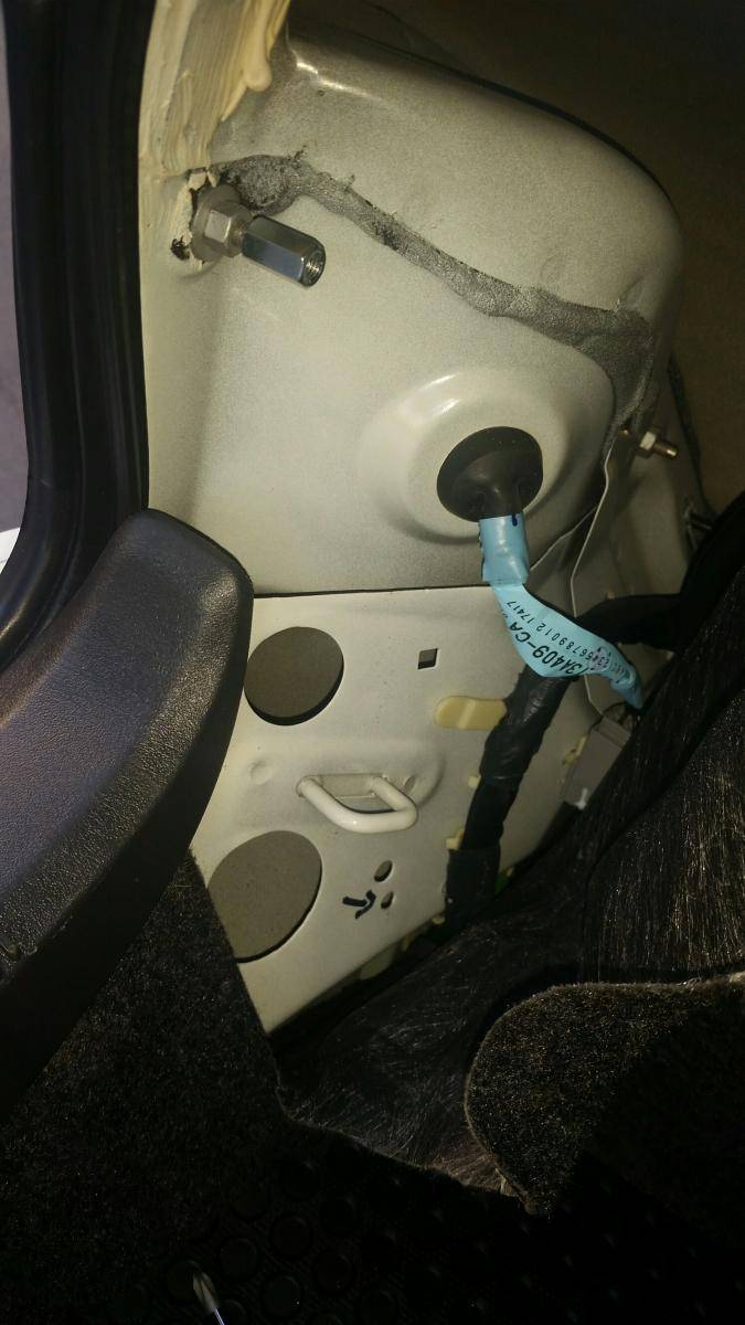

Completed the cargo net install. Could not locate the original mounting hardware so I found a new Ford cargo net with hardware for $11 on eBay. I am using the original net that came with the LS vs. the new Ford one as it is a slightly different design that I prefer.
Bought a couple 6Mx1.0 Allen bolts and 2 connectors to use on the top mounts that connect to the top existing bolts on the taillights. Used the standard provided hardware for bottoms

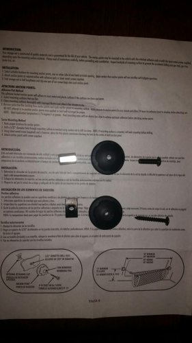

Net /mounting Part # from eBay order

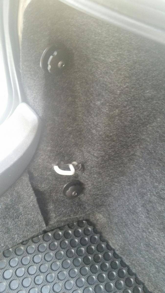

Top connector attached to top lamp bolt - used a little Loctite to keep it secure. For bottoms on my 2006 I was able to use existing holes in the sheetmetal (see arrow) on both sides.

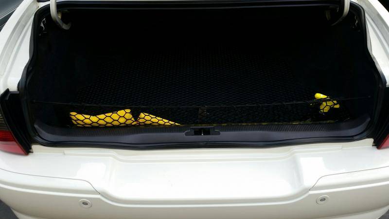

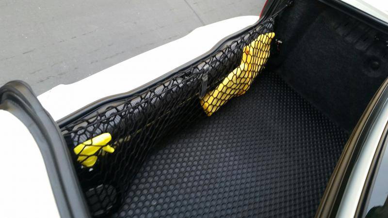

Finished product - happy with it for about $15. It does stick up a bit over the trunk threshold, so I can see how it can get in the way of loading, but it is so easy to un-attach I don't foresee much of a problem.
Looks good. I guess I should shorten the top elastic band on my net so it's taut like that, as opposed to drooping over into the trunk latch. Mine isn't from an LS, though. Someone traded in a Golf hatch and left the net in the back
