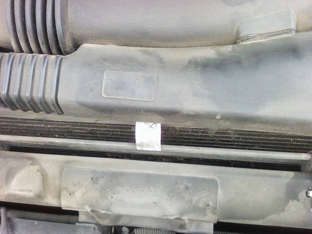

You may want to check and see if the rad is getting plugged up with road crap.
What you do is pull off the plastic cover that sits between the headlights so you can see between the ac and the rad.
If there's crap you can vacuum it out using the attachment for doing corners or some compressed air.

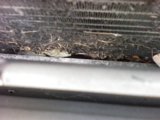

ok, it looks like the radiator is full of crap...
but is there a good way to clean it if I dont have an air compressor? The space is too tight for even the slim vaccum attachment.
Does anything have to be moved? Or should I find an air compressor?
Also, does that look like it would cause overheating?

To do the ultimate job you would have to remove the rad or at least remove the fan and blow it out from behind.
I coincidentally looked at mine today while changing out one of my HID bulbs and there was some crap, less than yours and more near the top.
My air compressor at home is small and good for a nail gun so I couldn't get much cfm out of it but it did blow the stuff away.
Tomorrow I'll blow it out at the shop where we have a big air compressor.
In your case I would consider removing the rad or having it done and doing a good clean out job.
Can't say for sure if it's causing your overheating but it's sure not helping.
Without seeing if the core is packed with finer debris it's hard to tell.
I think the compressed air may be enough to clean it up.
I'd do it as more debris will keep accumulating.
Blowing it out with compressed air is a no cost no big deal.
