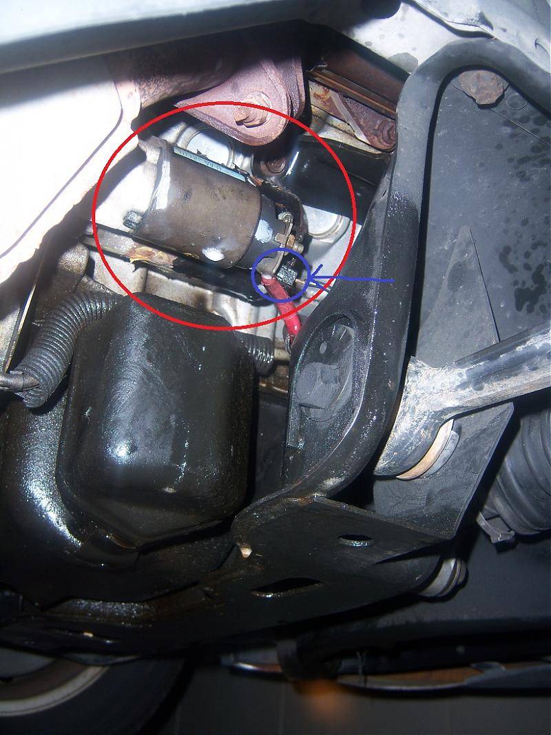

Go under the passenger side door and look right beside where the transmission mounts to the engine and the starter is right there too. You can't miss it. Loosen and tighten the wires down there. It has to be done from under the car.
Ok the red circle represents the solenoid and the blue circle are the wires that usually get corroded, right? I tried moving the wires but only the black one moved and it didn't help. I guess the next step is to actually loosen and tighten the wires and see if that works.
