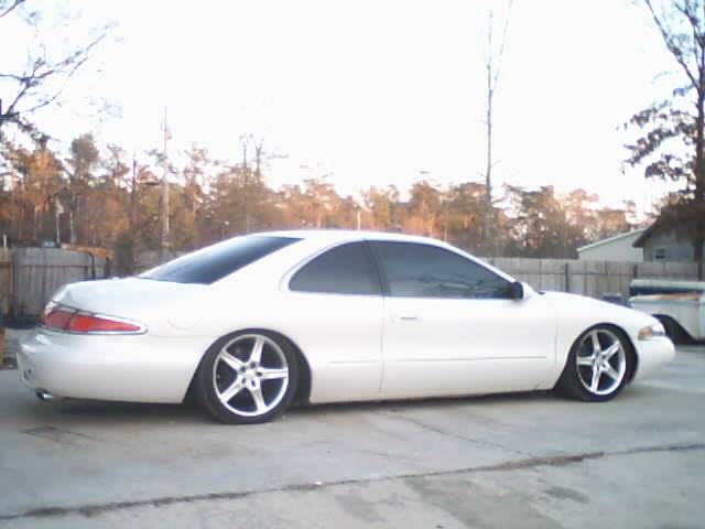

Well i accidently lowered mine,back when i first got my Mark I didn't know anything about this forum,thus i din't know anything about turning the switch off,an who reads the manual? :shifty: I jacked it up with the switch on an thenwhen i let her down,Icouldnt get the jack out,for some unknown reason I left the key to the 'on' position an it dropped down...I liked it,so I did the back,and now,it looks sweet. So give it a shot,but turn the switch off after your done droppin it so she'll sit low.

Proof is in the picture,thats right after I did the drop job. The only problem I ran into was getting the jack out from under the car. I didn't ride around with the car like that,it was just for looks. I lifted it up just a lil bit and then rode it round.
