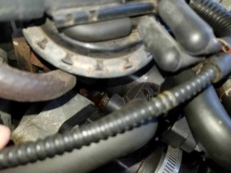

Well I just did that and there you go. A big puddle on the lower intake. Even down by the oil cooler. Wasnt there 2 weeks ago. Its right under the elbow thats under the EGR that goes into the lower intake... however the TOP of the flange has a lot on it to. Being its a year old I doubt a crack. I think the gasket that goes into the crossover pipe didnt seat right.. i "specifically" recall putting it together and it was very hard to force the elbow in to that cross piece. Im really suprised it started months later and is getting worse.
I suppose I have to the EGR off as well as TB from the upper intake as well as the crossover. What a PITA.
Lube that O-ring and back side of the crossover with a little coolant,,, and it should go together much easier. Might want to check the crossover for hairline cracks in that area... especially if you bought/used an aftermarket one... or if it's original to the vehicle.
While you're in there,,, make sure the throttle body heater hose is in good shape... and not overly soft. If it is... you might want to replace that too, if you have the time... (because it's labor intensive). Best to do the elbow too... if it's not newer.
