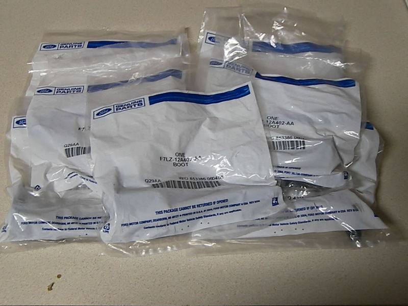

I got two plug boots last night but it was to dark and cold outside to put the one on. So I'm gonna have them order one coil at work today and I will put it in during lunch. Just sucks that it has to be under the intake tube :mad:

However I went out during my lunch and took off the intake tube, pulled the coil cover and yup OIL :(
So I had also picked up a new coil assembly just in case, so I just put Dielectric grease on it to try to keep the oil from creeping back up for now? I will save the coil I took out and test it later so I can keep it as a spare.
