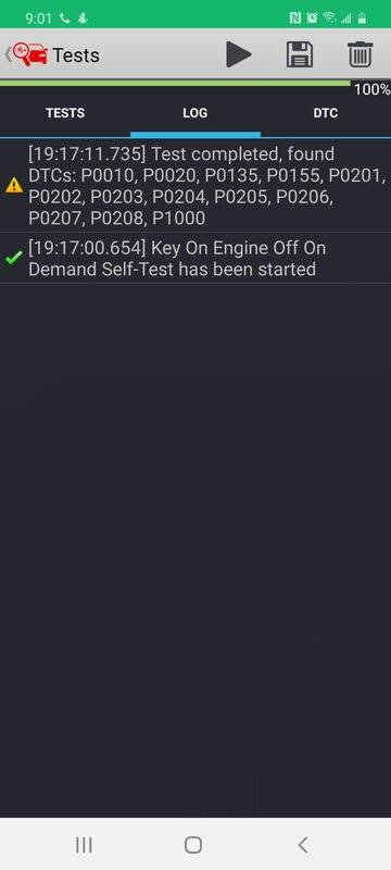

ok i got an 06 Lincoln ls that I just put a new motor and transmission in it was running just fine till today when it just stopped firing properly. I have also replaced the cops and plugs in it with Motorcraft parts help out of ideas
Well, the answer is right there in the codes, and couldn't be much clearer...
You have a problem with your engine wiring harness or don't have it completely plugged in.
Your camshaft sensors aren't making connection.
Your O2 sensors are making connection.
All of your injectors aren't making connection (or the fuse is blown).
Thanks for the reply. I'm really thinking it is the harness or a ground because she just starts the stuff randomly.
