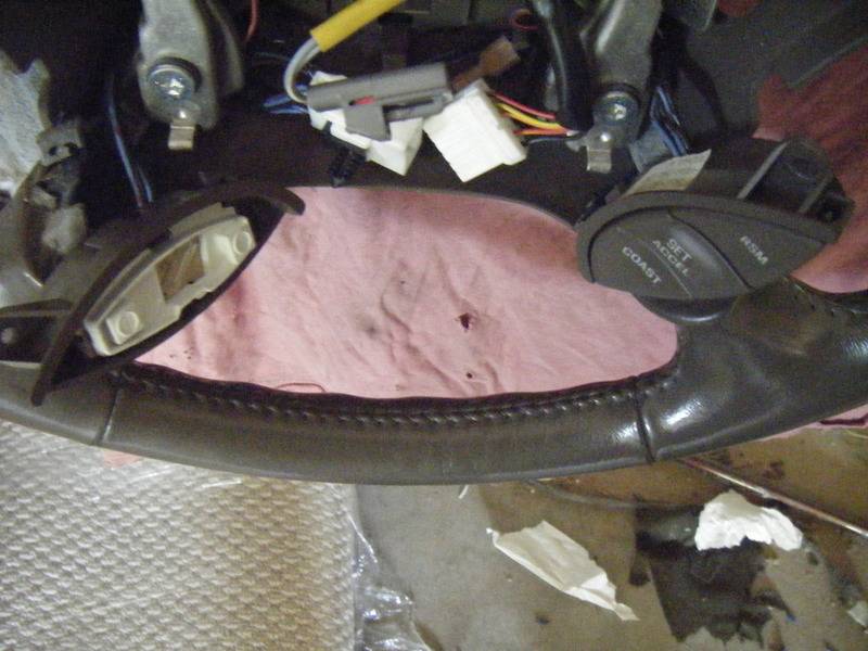

Sorry for the crude pictures, but yes, the tops come off. You could probably just use the light/panel portion into your existing switch. Dude selling that "New" switch is out of his mind. Everything that I find in the jy from now on will be listed as New-other, I'll just say that it was bulk packaged.:rolleyes:
You do have to remove the airbag to get to the switches.
1- Disconnect battery
2-Pop the 2 plastic covers behind the wheel and remove bolts
3-Remove airbag and disconnect any connectors holding it on.
4- 2 screws hold on each side, remove those and iirc you gently pop off the covers.

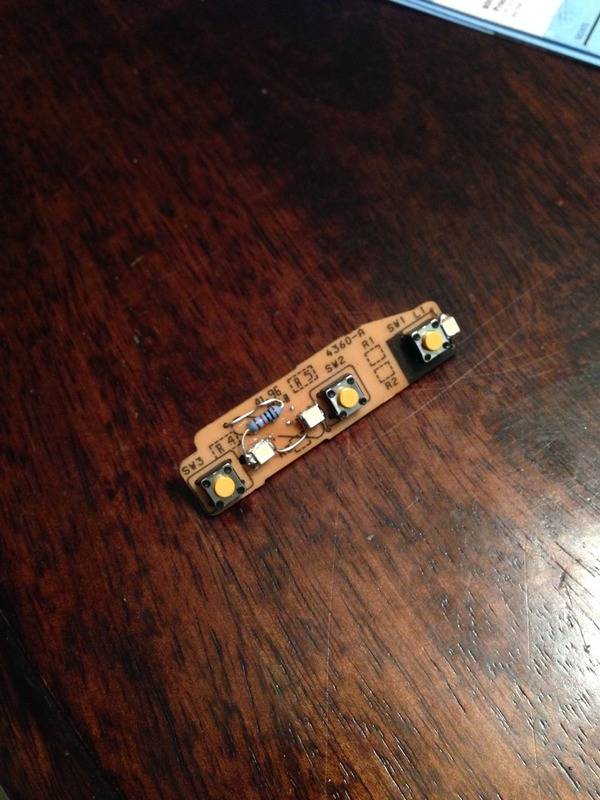

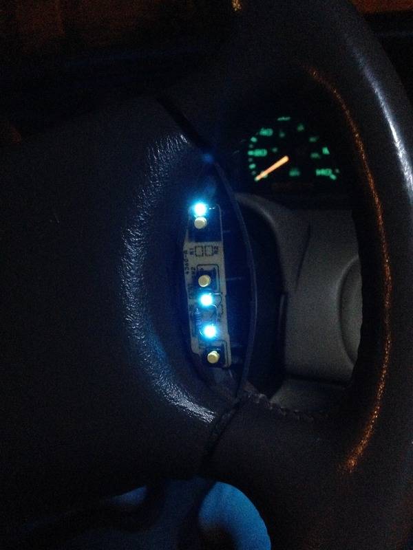

Been playing with mine, using a trim too I could pop them off without taking the airbag off. Posted in another thread, but, I could have "new" circuit boards made to use LEDs instead of lamps.

You do not need to replace the complete switch. Just unplug and snap out the board with the bulb and buttons on it and replace it with a good one from an Explorer or F150. Pry off the plastic cover, remove the rubber insulator and pop out the board and bam, all better.

I never did try lamps - couldn't find anything on the out there, so I did this instead.
Frank where do I get them and do you have a part number? How hard to hook them in? Is the light bulb color the same as the OEMs?

Surface mount LED's are cut out off of a PCB, and then superglued to the factory cruise module. Resistors were used to limit the brightness.
