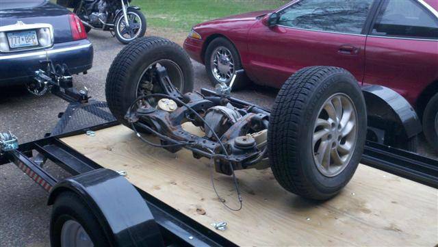

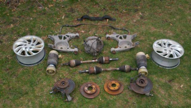

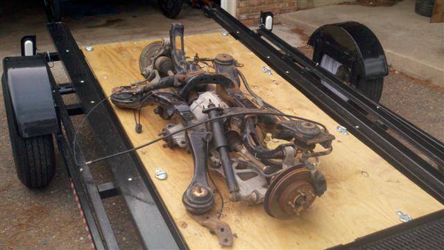

I just did this on a 98 parts car. If yours has rust, I wouldn't recommend it.
I ended up having to cut off 3 of the 4 main bolts after the heads broke off.:D
I thought it would be easier too.:)

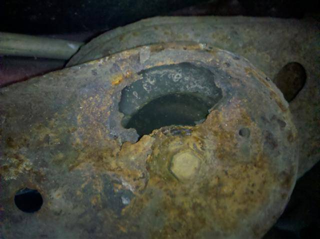

its supposed to be easy, but not on a northern car, down here all you need is an impact gun and 10 minutes and the rear is out whole. its very hard to get the 4 main bolts out in a rusty car 9 times out of 10 the nuts inside the frame break loose and after that you need a torch or a hole saw to cut through the frame to access the nuts.
Get out the hot wrench and go after the 4 bolts and the rest of the lines (if you don't need them).
like they said rusty...but do-able

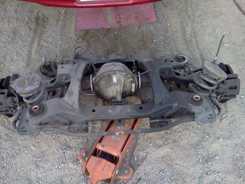

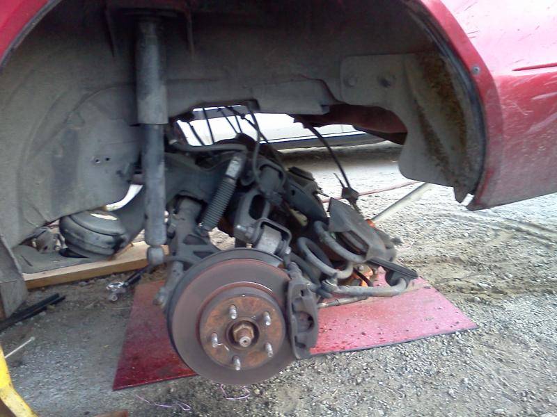

it came down in one blow ez as pie. Not an ounce of even surface rust, literally and the 4 bolts spun right out...remaining were the shocks, brake lines,driveshaft, ebrake cables, and some abs lines.....so ez it's crazy. I'm gonna bolt it all up into my keeper mark just like this.
Then why part it out?:D
i need the parts, plus it was "jumped" by it's previous owner, and has a bent frame.
