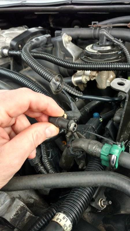

Can anyone tell me what line is broken here?

When changing my valve cover gaskets and fuel injectors it looks like a vacuum line of some sort got broken and I can't find the other half of it either. Does anyone know what this line is and what it goes to?
I don't know too much about the 1st gen, so just guessing...
Did it break off of the fuel pressure sensor? It looks like the fuel pressure sensor is nearby.
Thanks man You rock that is where it was. The hose is completely gone lol
Glad I got a fuel pressure sensor from the junk yard a few weeks back cause the line is completely broken off that as well and there is no nipple on it anymore.
