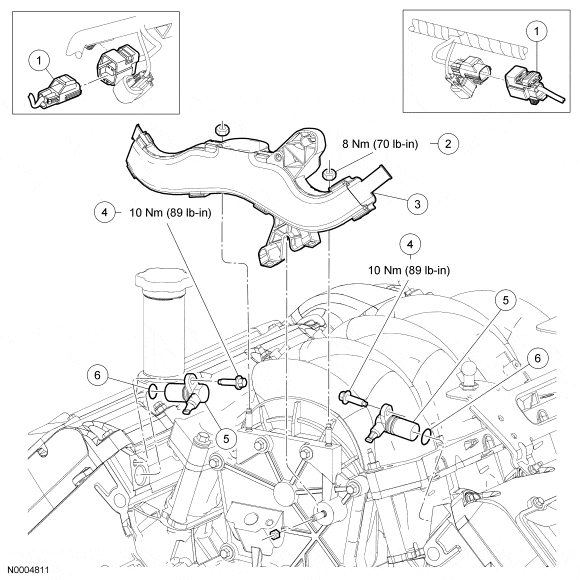

Bank 2 is the driver's side. CMP (on each side) is at the back of the engine on the side of head facing inward (end of intake cams). You may have to loosen and push aside some wiring conduit to get to it.
CMPs are item 5 below
Note that it could be the wiring instead of the sensor itself.
