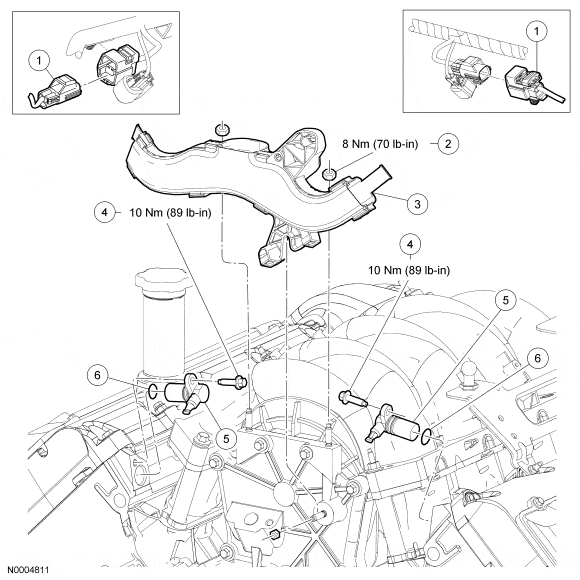

I'm getting code p0340 after replacing VC gaskets. I have read in post that the sensors on top of the VC is for the VVT. If so where is the camshaft position sensor located? Those sensors on top of the VC is the only sensors I can see anywhere near the camshaft's. Thanks for any help and I pray all are safe and well during these times
Those aren't sensors of any sort on the front top of the valve covers. Those are actuators. They control valve timing, they don't sense it. The camshaft position sensors are at the back of each bank, facing inward towards the intake manifold.
Labeled 5 below.
Found cut wire. I guess when I put VC back on. Code doesn't seem to come up at start up. Taking for test drive. Thanks Joe
