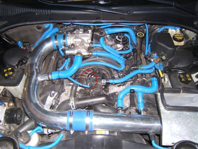

the CMP is the single connector on the passenger side of the engine - just to the right of the cooling tower - see pic.
IIRC - the sensor is held in with a single bolt. Just follow the wire....

Thanks again Quik. I kept the chains so i can post a pic of the snapped one. figure it's like a battle scar to brag about (sarcasim : don't wish it on my worst enemy). Anyway, should this help my situation by just plugging it in cause i have the sensor (thanks again max) or does the computer have to get "rebooted" so to speak for this car to run right again? thanks again
nope - if the cam sensor is the problem - then a new one 'should' fix it.
