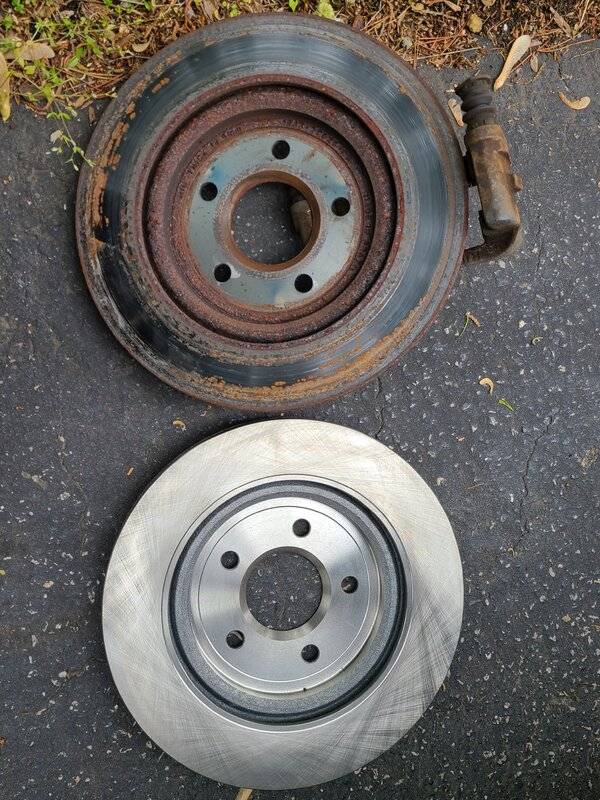

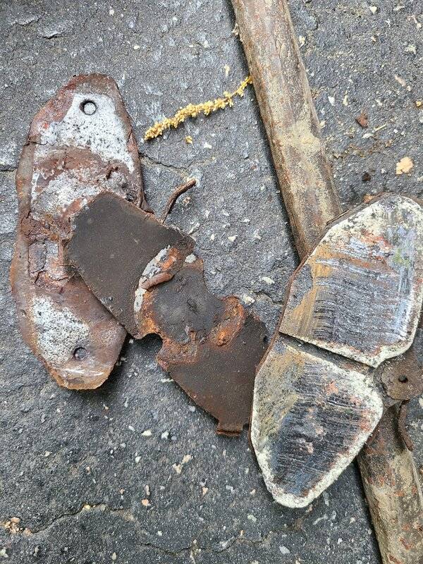

After digging through forums the creaking noise pointed to the caliper. Before this happened when I had an oil change I was not able to freely rotate the drivers wheel so the piston was already dragging. I guess this is what it sounds like before it seizes 100%... again like my last cars it went away on its own but still got a new caliper. $50 at autozone lifetime guarantee.. WISH I had done this on the rear and not used the shitty FORD OEM rebuilt caliper..
Within a year and a half the drivers side got roasted. Pads melted down. Pin seized up caliper also.. the passenger side still had life on it and the AF caliper looked and moved like new still. The FORD side looks older then the car itself... $50 for an autozone one again. I had planned on rear brakes before winter but yea got done earlier. Shortly after my rear wheel bearing went out again..

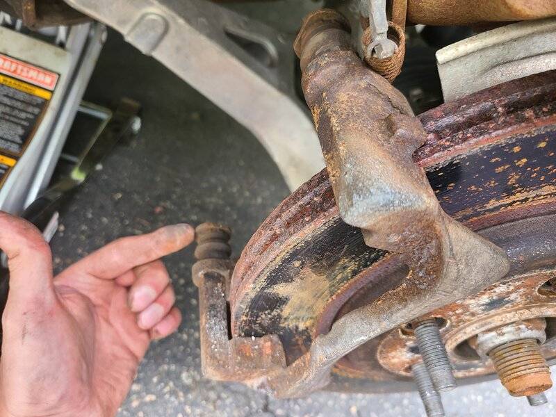

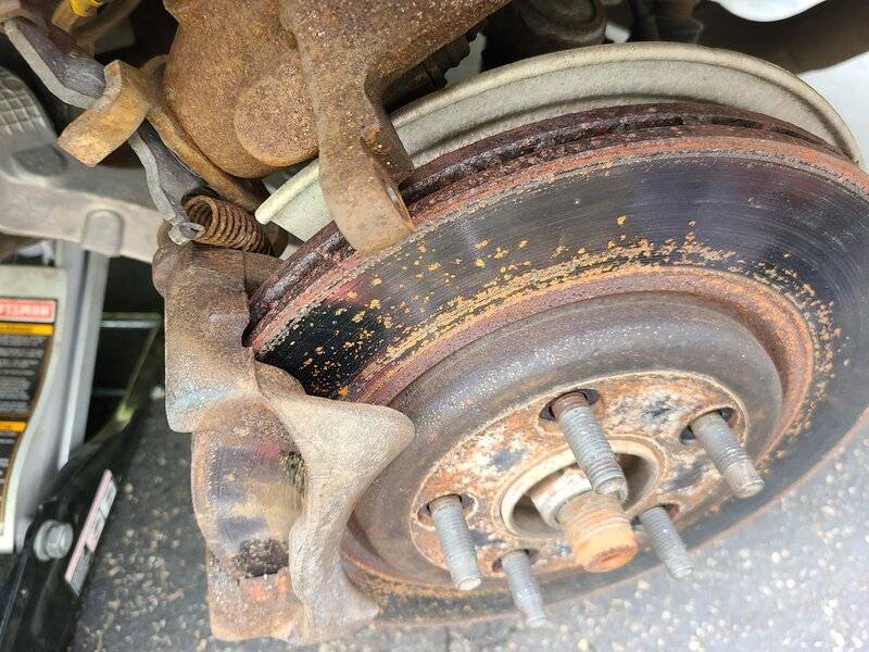

Actually... from what 88 said... i gather that a caliper slide pin froze up... and wouldn't allow the brake to release.
The main giveaway on that... is what he is pointing to in one of his pics.

Yeah pitting in the rotors is a dead give away that the calipers are frozen in place.
I had this problem with a 88 Regal years ago. Bad brake design in the front. Stainless steel pins would still freeze up don't matter how much you greased them and made sure it moved easily. Even a class action lawsuit for it. Cleveland winters didn't help either.
