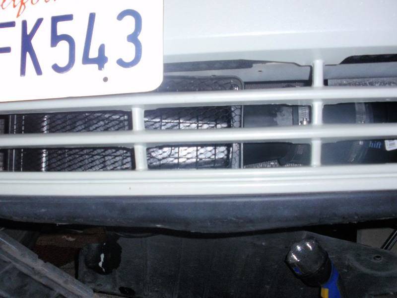

i did it this weekend. took me a while. here are some pics. I finished late so i didnt drive the car but tomorrow i will
[/IMG]
So its not going directly to the intake tube right? Just into the engine bay?

to the OP, looks like you did a pretty good job fabricating that snorkel type thing. I woulndt have spent that time to only use it at speed.... when your acceleration is done. Are you tuned? You may want to get some FLAT black and spray that whole piece so its hides better than the matte finish of the plastic.
Why would that only work at speed? It is still drawing in air that is colder than what is under the hood, correct?
I just don't see why you would want to risk messing up the motor by making something that would direct water and other debris towards the intake just for alittle bit cooler air which will not make a big enough difference anyways, but different strokes for different folks
Actually, it makes a pretty large difference IMO. I really need to find the link to that chart of the air temp vs hp gain. Plus he has the mesh on the front there not that anything is really going to get all of the way up that tube into the airbox anyway, at least no more than what the stock air box gets in it. There are a few guys that run that setup and they don't worry about driving through big puddles!
I had a March Ram Air set-up on my old 87 LSC, and that sumbitch sucked up EVERYTHING on the road. You shoulda saw the crap that was in the sealed box - twigs, sand, pebbles, etc.
Mesh doesn't stop water and you'll be wishing you didn't have it there when you are walking because you got stuck in a storm and sucked water up through the intake. Just not worth it to ME, but that's just me not saying that is god's word
How do you figure he is going to suck water up into the intake? It's not like the hose is connected to the filter or anything, there is no sucking action involved, lol. That's why sully made the at speed comment. All it's doing is feeding the colder air from the lower grille up towards the area of the filter, they're not directly connected. Now if he had run the filter to the lower grille, then that would be a different story.
How do you figure he is going to suck water up into the intake? It's not like the hose is connected to the filter or anything, there is no sucking action involved, lol..
If air can get there than so can water. Did you just say that there is NO sucking action going on around the intake?? Really??
What I meant is that this hose that's run to the lower grille is not directly connected to the filter so it's not going to be sucking in water. Yes the filter is sucking in the air around it, but it is not directly connected to this hose for air. If he had run his filter down I would say yes he has a high chance of sucking in water but unless he's driving in a damn tsunami or taking his LS through rivers I like his chances of not getting water in the intake from this set up. The air brought in from this is more from the force of the air being pushed in through the lower grille not by the suction of the filter. Water would have to hit the lower grille where his box was placed and travel all the way up the tube to the filter.
