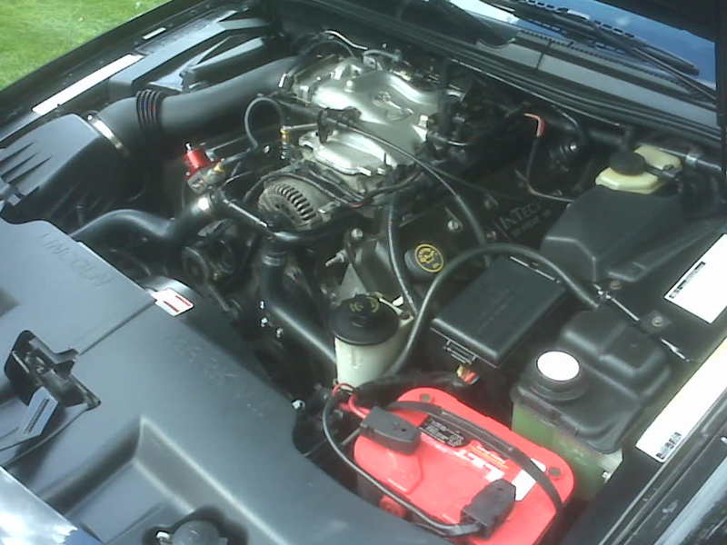

i just completed a 99 cobra head and intake swap on my 98 after a headgasket gave out and i gotta say it wasn't the easiest car i've ever worked on lol but it sure runs alot better especially in the midrange
no power adders for this motor as it's still has a stock lower end but i'm planning on building a 3.70 bore aluminum block with all the good stuff

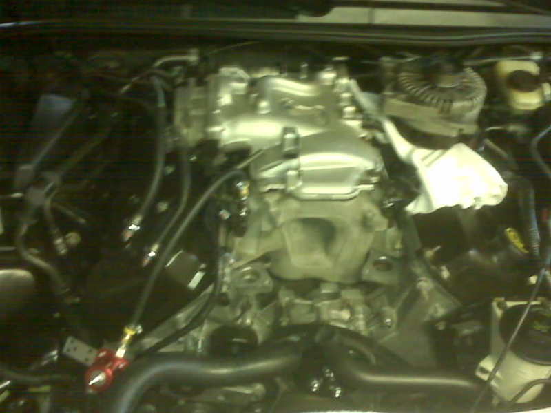

that certainly is an odd fuel rail adapter, leading to a regulator...and based on your username.. I have a hard time believing its not got "some form" of an power adder.
lolz
lolz
lol spraymax is my company name we spray alot of commercial and industrial coatings, we just slapped it together now i'm on a mission to make it all look good
the lincoln fuel rail has a return style system and the cobra does not so we fabbed a return of our own for the moment (new stainless lines this week) with a regulator which is mandantory
so now a cold air intake and a tune by Lidio and that's about it motor wise for the moment

after I posted that, I noticed it wasn't a stock intake..lol
thanks, after i drove it around for a while i noticed it was running a little rough so i replaced the last 2 factory original coil packs now it's smooth again it runs excellent
