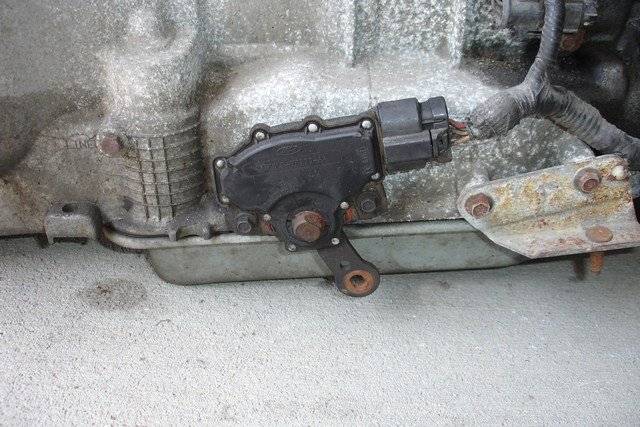

how to you bypass the transmission range sensor so you can activate the starter. the transmission range sensor it the one that makes sure the trarnsmission is in park or neutral so the engine can crank. please help!
Why would you want to do that? But I am not sure how without removing it.
Do you want to just bypass it all the time or do you want to attach a bypass to function as a neutral safety for you manual tranny? I have the wiring diagrams so once you let me know this I can help you with whatever way you want to go.
Look for a Red/Light Blue wire on pin 1 and a White/Pink wire on pin 4. Connecting those two will be as if the MLPS is in park or neutral.
thanks,
I want to bypass it all the time, it would be great if you could send me that wiring diagram.
there are 2 plugs in the car wich one are you talking about the square one or the circle one?
Do you have the transmission harness? It's sort of oval shaped.

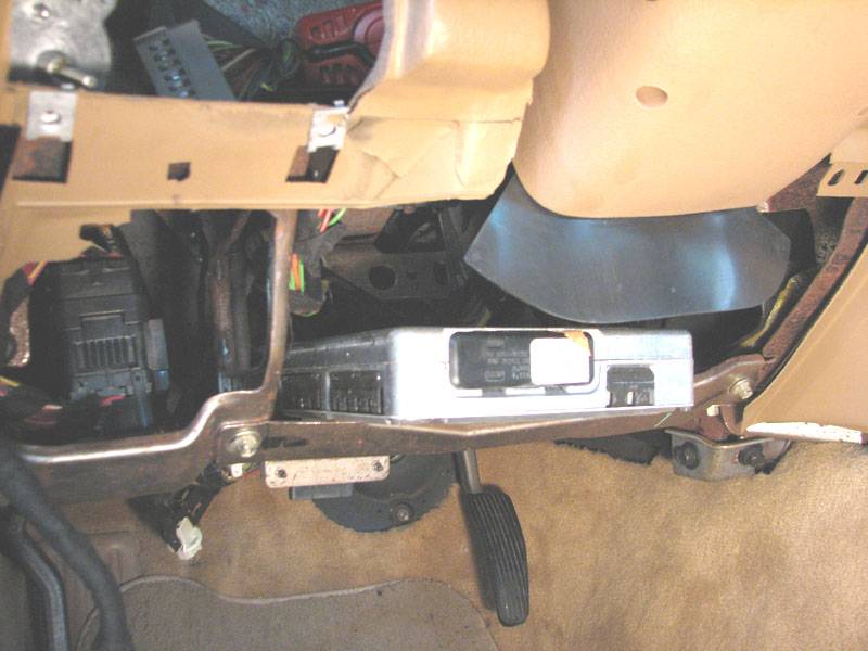

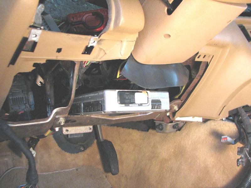

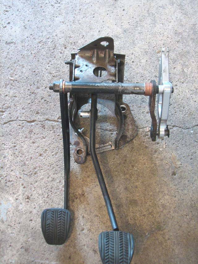

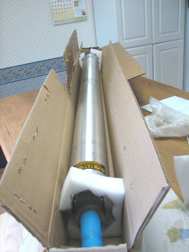

It is not that hard everything basicey bolts right up. The only major fabbing that has to be done is on the shifter and the pedal. Even that was not hard i got a mustang clutch pedal and took the clutch pedal and tube off and rewelded it on the marks pedal. i will try to get a pic of the pedal up later today. I did not even have to extend the wiring on the ecm if you look under the dash wear the ecm it there is a big plastic tube that runs across and give air to the two vents (one by you foot and the other right to the left of the steering wheel) i just Cut that tube out caped the end and the ecm lays perfictly there. i will get a pic of that too. the only down side to that is you no longer get air out of those two vents but if you want you can take a tube and reroute the air over the ecm. the mark is not running yet i just wanted to makeshure the starter worked. i have to make a shifter also i am still waiting on my new driveshaft (should be hear later this week) and have to build it an exuast. i was thinking highflow cats through glasspacks and then bring it out on the side like a cobra R. i will get some vids up when it is running with should be in about a week or two! till then i will get some pics!
just got my driveshaft while posting this!!!!!

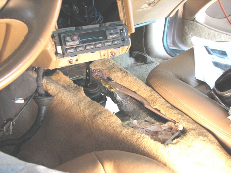

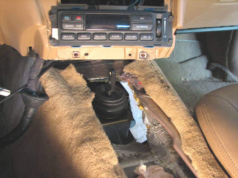

That is false atleast with a cobra trans i have heard that it would be closer if you took a gto or firebird tailshaft but I did not want to start taking the trans apart. there are two places on the trans wear the shifter can come out of my shifter is as for as it will come as you can see in the pics it is not neearly far enough. when i build my extention i will take pics of that to. I used a mechanical clutch setup that is for mustangs. i will not lie this setup is not perfict but will work for now. alot of wires are rubbing the pedal but it should work depending on how good this setup works i might go back and swich to a hydrolic setup. hear are some pics :)
