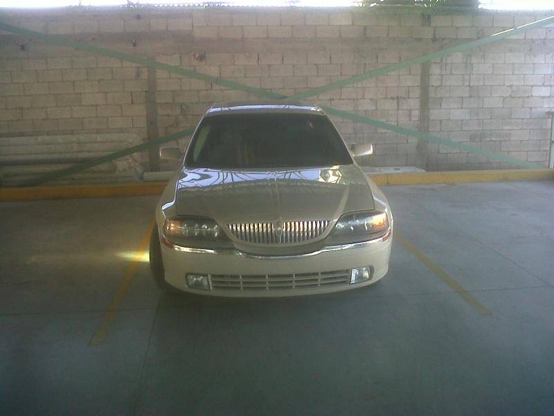

i changed my pcv valve and valve cover gaskets. everything was ok when i turned it on, i let it idle for about 10 mins and i was taking it for a drive. i drove like 4 feet without accelerating and i heard a weird metalish noise, and it stalled and wont turn on.
i had it towed to a electric shop and they told me my cranckshaft wont turn. engine locked up. i need to take it to a mechanic shop but they told me it'll cost around 2,000 dlls or so. its a 2002 v6, i dont think its worth it. because i;ve seen those cars being sold for 3,000.
i guess ill just drive a f*cking honda or some stupid unimpressive car until i buy another luxury car. but thats what i get for messing with lincoln

i want that grille, i got a tri coat 05 and i want one of those grilles.
