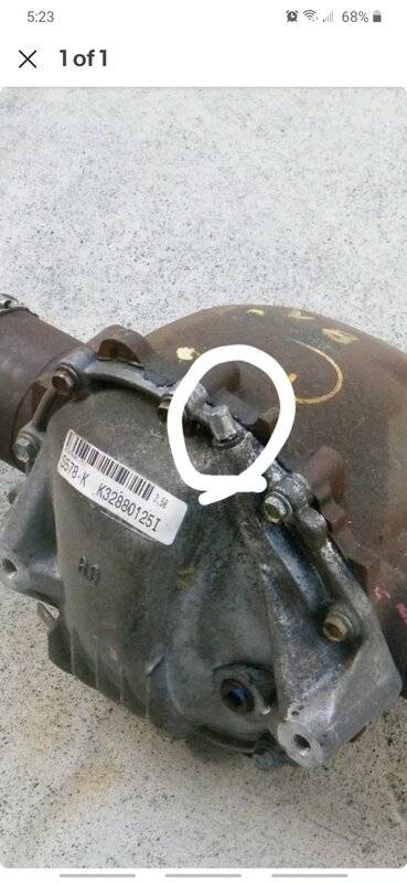

Well noticed a very wierd high pitched buzz noise coming from the back end that vairies pitch and also only starts buzzing around 45 MPH, looked at the diff and noticed the very top leaking and there was no leak before, the buzz does seem to go away after a bit of driving. The leak seems to be coming from the place circled in white.
That is a breather vent for the diff. They typically have a built in check valve, (but not always), to let pressure out as the diff fluid heats up.
Yours may be plugging up or failing... and as the diff fluid heats up it is building pressure... forcing a bit of fluid out the vent.
Either that... or if you recently did a fluid change, you may have over filled it. Or... the diff is low on fluid and getting hot... causing excess pressure to vent out the vent.
Either way... it might not be a bad idea to check the fluid level in the diff.

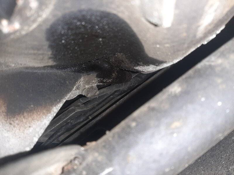

I just went out and drove it again after it sat for awhile and got fairly cold and I didnt hear the buzzing noise this time, maybey the highway drive home got whatever was out of whack back in wack but my Hope's aernt up.;)o_O:(
I think that would be enough to cause me to change the oil in it. I wouldn't go all out and drop the differential to get the cover off. I'd stick a hose in the fill port and try to suck out as much of the old oil as possible and then refill.
Fortunately, neither of mine ever made any noise, so I never touched them.
Yes I will probably change it, so far it hasn't come back.
