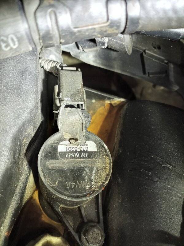

All three on the driver side look like this to different degrees. What could be going on here? I can't see the other 3 yet.

Replacement of all of those coils (COPs) is a really good idea, but I don't see anything "burnt" about them. I see rust where water has been pouring on them from the wiper cowl. You need to get the $5 wiper cowl seal repair kit if it is still available, otherwise get some weather striping and improvise something. The dabs of RTV on the coils is because the latches on the coil connectors (harness side) have broken, so the RTV is one of a few ways to keep them plugged in without actually replacing the connector housings.

Yep, looking at them a little closer today. You are right on the spot

I have the cowl off now. I guess I will have to fabricate a seal. Does anyone know the Ford part # for the gasket? to keep water out?
