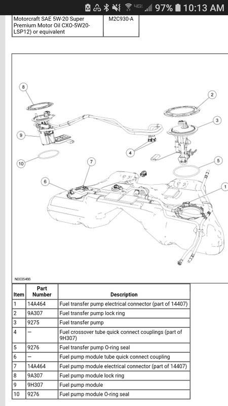

What are the fuel pump elbows themselves actually called
This is a 2nd Gen Fuel pump assembly but they're called the same thing as 1st Gen 2000-2002
Thank you now if the parts store or any salvage yard has those I'ma get my baby fixed I also downloaded forscan and did that oh my my baby looks bad on paper but so good on the road she runs to good to have the things wrong that thing said it did but nonetheless I'm gonna have to work on fixing her cause she is just a cool fast car and I dig her thanks y'all have a wonderful new year and since these cars tend to have issues bet I be back asking something else til then thanks again
I can not find one of those couplings in any parts store or even listed online so far that i can order so my question now is why the sam hell did they make these killer vehicles so stinking ass backwards pardon my language but nothing on this car makes good sense to me from the transmission fluid having to be put in underneath it and not having a dipstick to check it with to the battery being in the trunk and why would you put a cooling system like that on anything but they are sleek and swift and so fast I cant help but love these cars and always will just had to vent sorry yall
