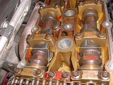

Like Fbird said, did you rotate the engine to where the "flats" of the cams are straight up to make sure the cams are in the correct relationship? I just want to make sure I understand you right. If the cam did indeed jump a tooth the scribe you made would be in the wrong place when you re-assembled the engine by that scribe. I'm sure you have seen this pic.

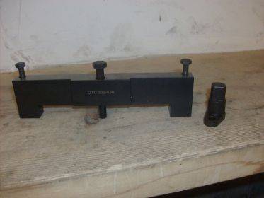

Ideally, when doing the timing chains there are two special tools that lock the cams and crank in place before the sprockets and chains are put back on to assure the cams are in the precise location. I know some guys have had success without these tools, but I like that peace of mind.
Before i removed the broken tensioner i scribed the cam sprockets and the chains. I then pulled the exhaust cam caps to remove the secondary tensioner. It is also important to note that before i scribed the cams i did notice that the flats on the cam were not perfectly aligned. I thought, never doing this before that once the new tensioner was installed it would be aligned. However once i torqued the tensioner and the cam the scribes were aligned but the cams were still not flat. Is there a thread on how involved it is to time this?
Ok, if they are off that can be the problem. Do your remember how far off they are? I know some of the guys here have a link on how to do this, but I can't remember who.
To make sure the engine is in time is not hard at all.
You have to take off the valve covers, rotate the engine to TDC and then an additional 45 degrees. On the Torque converter cover there is a small plastic plug that you have to remove along with the crank trigger sensor. Inside you will see a crank trigger ring that has some square holes. One of those holes is a special shape and that crank tool fits in where the sensor was into that special hole in the ring. That tool holds the crank in the right spot.
The flats of the cam should all be facing up. You would then use the 2nd special tool to lock the cams in place after the sprockets and chains are off. This puts the engine in precise mechanical relationship. With the 2nd tool still bolted down, you would then put on the chains and sprockets on and torque everything down. After that you would remove the tools and re-assemble everything.
This is just a quick rundown to give you an idea but that is the correct way, but like I said there are some members on here that have done things different with positive results.
