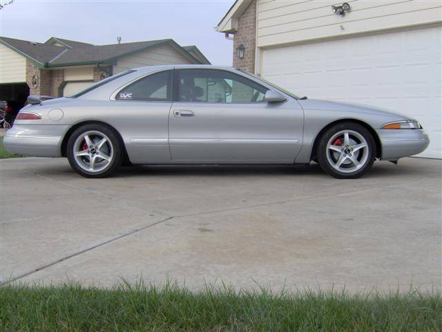

JP, What year cobra did you get those calipers from? What all did you have to do to get them on? Why wont the 16" work?
These are typical Cobra 13" brakes. The 16 inch stock wheels will not clear the larger brakes.
www.discbrakesrus.com
This mod was done by the previous owner of my '96.
the r1 concepts brakes work with 16" wheels. i need calipers that do the 16" wheels too, cause I put the stockers on in the winter.
