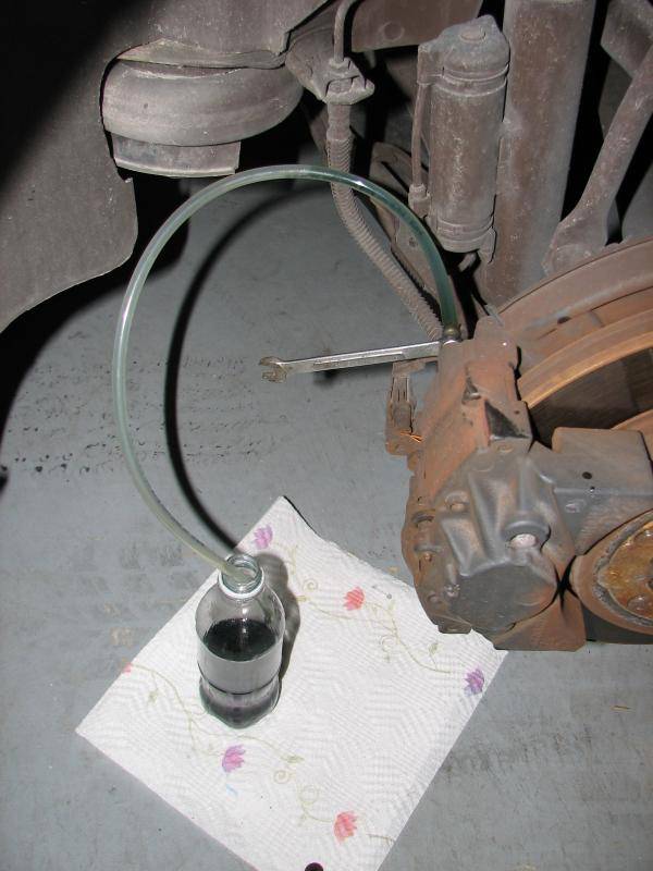

I always attach a hose to the bleeder and open it slightly before pushing/screwing the pistons in. I don't like the idea of forcing a lot of possibly dirty fluid back into the master cylinder where it might damage the seals. Every now and then you hear about someone that had there master cylinder fail days after a brake job. I could be wrong, and this might not ever be the cause, however it's an easy thing to do with no downside. (Okay, you could say the use of extra brake fluid is a down side, but I like to try and replace most of the fluid on each brake job anyway.)
yes, a while ago I made a little fluid catch by getting two feet of clear tubing that fit tightly on the bleeder valve, then drilled a small hole in the lid of a clear water bottle and stuck the other end of the tub in with a zip tie inside the bottle to make sure the hose didn't come out.
then i do exactly what Joe described using the tube and bottle to catch all the fluid and keep from making a mess. as an added bonus, since some of the hose goes up hill for a few inches, it keeps about two inches of the most recent fluid in sight, and you can really tell when the fluid is getting dirty, so about every other time I do the brakes, I also use this as chance to flush out all the old fluid. the two inches of fluid in the tube make it super easy to see when the dirty fluid is out, and fresh clear fluid starts to come out.
while not my picture, almost exactly this
I learned the hard way to add the cap after the first time I used this, and knocked over the bottle!
