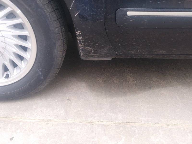

Brake fluid leak at proportioning valve
Dougviii
Feb 5, 2018
77
Montgomery Tx
I have a brake fluid leak that seems to be coming from the proportioning valve, it looks like the only way to get at it is to remove the driver side inner fender well liner, has anyone else had this problem if so any advice would be appreciated
