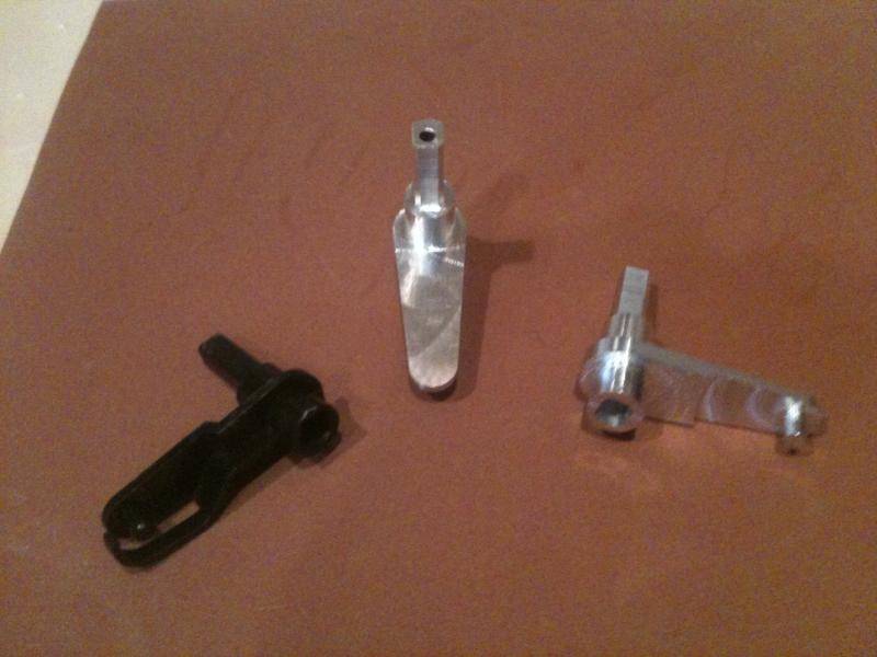

I just received 2 machined aluminum blend air door arms made by brother in law. I will test fit and adjust first part of next week. photos and update then. IMG_1610.jpg
