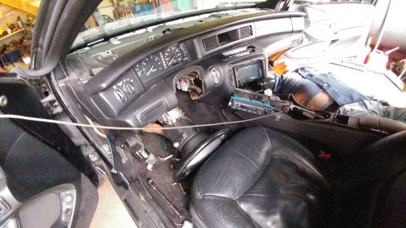

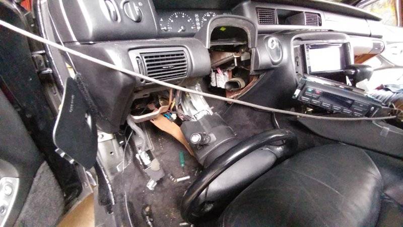

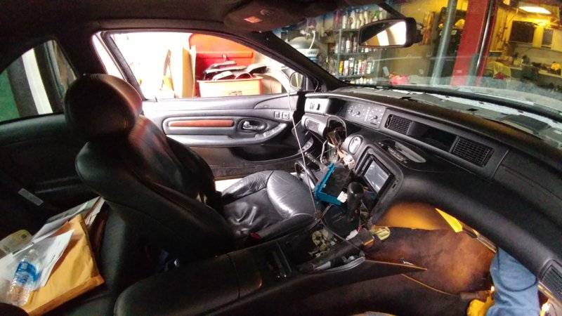

Mine is busted but a little zip tie magic keeps it working. I have no intention of fixing it judging from the pain it looks to change. If anyone is located near southeastern Pennsylvania who knows how to do it I'll pay!
I drove to Bruce, dbl88, in NH. I think mine was his 161st replace. For advice, parts, or repair, he has no peer. And he let me watch, and even help a little. But would I try to do it again on my own ......??? Nahhhhh
