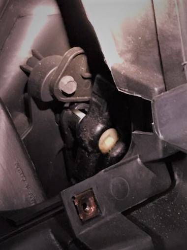

Well, I now believe my mechanic is ripping me off. He said the actuator wasn't busted, but the heater box assembly needs replacing. He showed me a picture (attached), and what it shows is the outer shaft housing of the actuator's arm is busted -- the typical break -- or am I wrong? He charged me to dismantle and reassemble the dash, without fixing it, and says he has to do it again for the whole heater box to fix for twice as much.

Is it me or does it look like the mechanic dremeled a hole to get a better visual of the actuator? If so, he might've taken a few panels off the front of the dash but didn't come close to removing it.
And yes, that actuator is broken.
Why not try a zip tie first. I fixed mine 3 years ago - cracked similar to yours and the zip tie has held great.

You may want to enlarge the hole or make a couple of holes in the bar that connects the two levers. Otherwise you will be doing this repair again - the hole isn't in the right spot and puts too much tension on the lever. This is why they all break over time - they are not the right distance/space. I believe you move the hole closer to the middle (thus decrease the distance between the original holes) only about a half an inch or so.
Guys please chime in if it should be the opposite - going from memory a few year ago.

Its not to bad at all to get to it. Remove headlight switch (pull straight out) then the headlight cover then thelong thin air vent cover, then the LCD display and you will see it and be able to put on the zip tie - if is cracked, the odd one breaks completely and zip tie is more tough if possible at all.

I also found the post that shows why they break and if you can get the connector bar off, you should enlarge the bottom hole as I mentioned above. You want to make the bottom hole larger or make another bottom hole closer to the top - you can gauge the distance by the pics in this thread:
