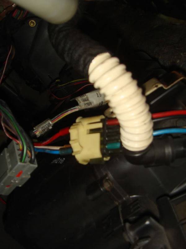

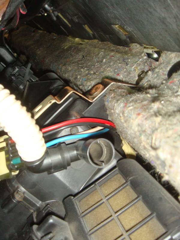

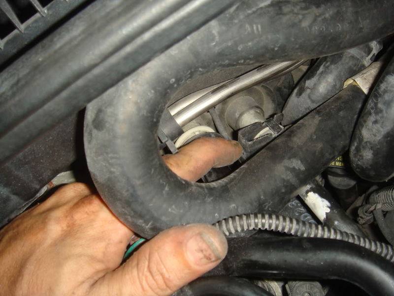

Here are pics of what I see behind the dash, under the hood, and under the front right fender.
To me it looks like everything is hooked up correctly except that hose you see in one of the pics behind the glovebox area. ( about 1/2 in diameter ).

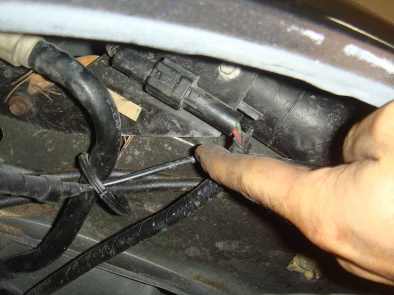

Black wire coming from the firewall into the engine bay.

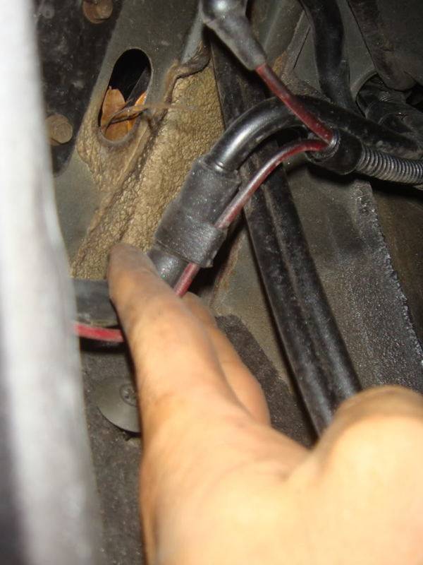

Vacuum hoses going to into the wheel well.

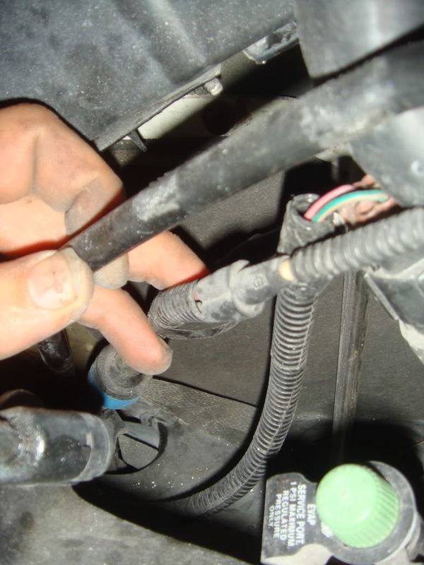

Vacuum hoses in the wheel well. and what is the cylinder thing up top?
don't know what the black tube is. Doesn't look to go to anything.

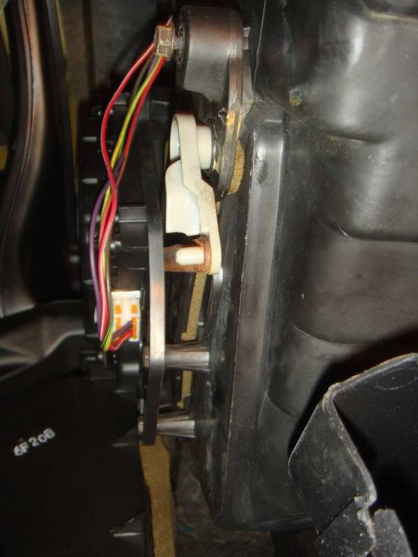

Looking at the blend door it looks like I didn't seat it right. The screw up top was missing also. ( the pic is with the bottom loosened a bit but it doens't look like it sat in there correctly does it.
Wanted to take a pic of it before I jiggeled it around. The car's off but I thought I should still be able to move it. Is that right or does the car need to be on.

the reservoirs can leak and they also have a checkvalve built in that can fail too
