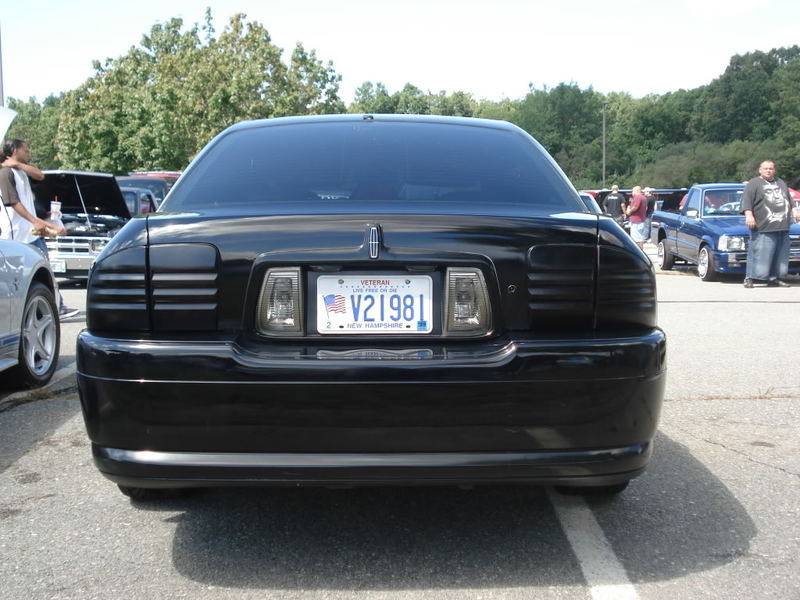

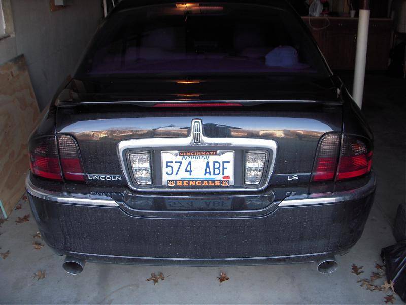

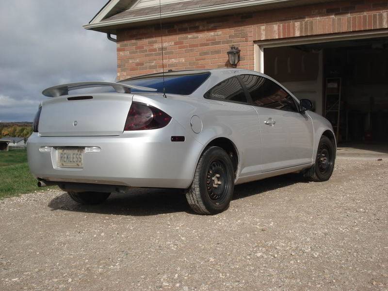

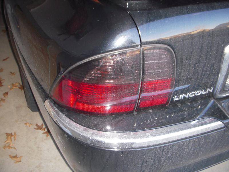

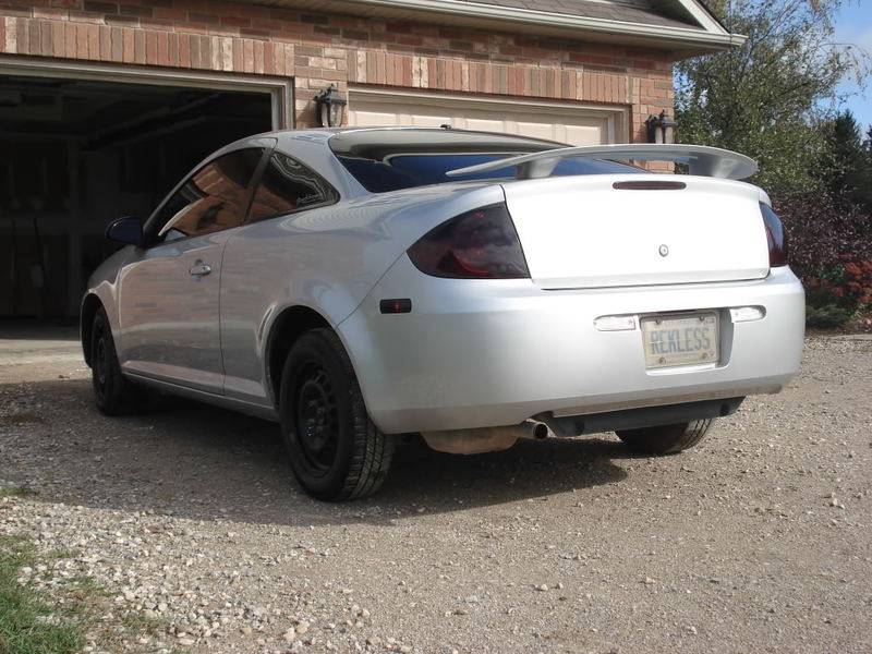

I'm sorry I don't have pics from the process.... but I did Sarah's on the G5 this past summer. If someone wants help with theirs or just wants me to do theirs..... I can take pics then. For now, here are some pics of lights I've done. I wish I had the G35 tails I did for a customer. Those were my magnum opus!
Before:
After:
[/quote]
