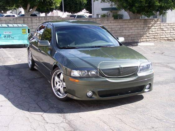

is their any special way to pain the trim bezel on the LS since its chrome? I want to give it the final LSE look by painting it green like in this pic....also for the rear as well.... does the piece just need to be sanded?
Why don't you just buy an LSE grille? Even if it's not the correct color, it can be stripped and repainted without the hassle of de-chroming.
isnt that the mclaren grille?... if yes, then there is no chrome on it, u can buy it from lskoncepts unpainted.. or painted but i dunno about that color

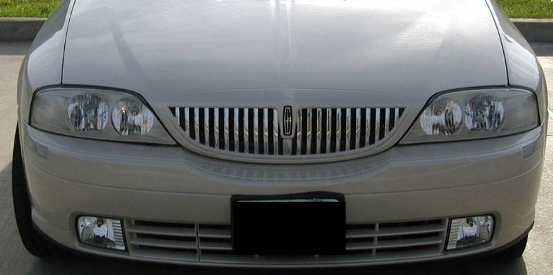

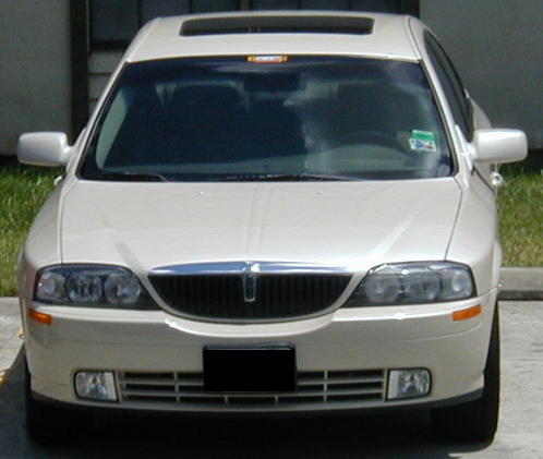

Before....
After.... and paint the headlight bezels at the same time, PLEASE.
