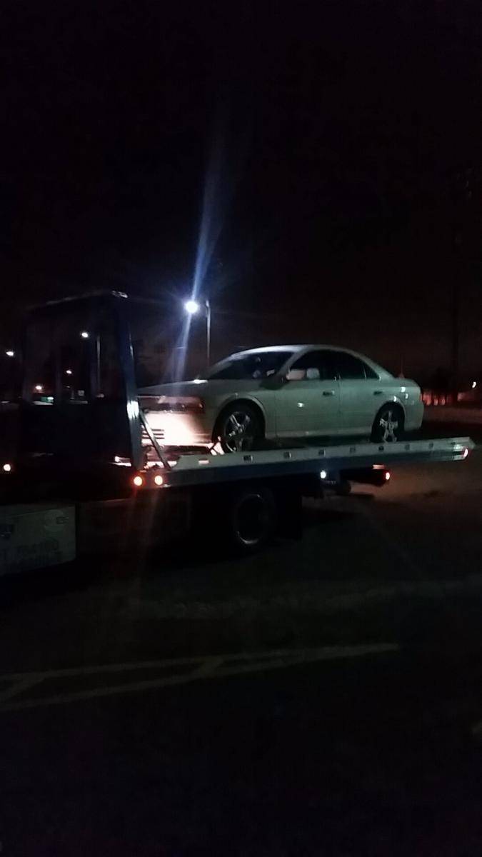

Sure enough alternator. $429 only though so not too bad. I get my baby back Thursday uploadfromtaptalk1424834552444.jpg
