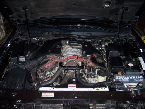

got my rad changed as with the t-stat , thanks for all help with this. After following the fill procedures took the car for a 20 minute ride around. Temp reading was sitting at 'A' for most of the ride, it made its way up to the 'M' for a lil then, headed back down to 'A'. Is this a normal thing to happen. Before i changed the rad, the temp would rise to 'M' a lot quick then it did during my 20 ride around. Any thoughts?
