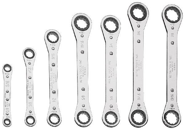

You gotta be careful with the Sears gear set.. for some reason the 10mm box in their set isn't punched all the way thru , so you can only fit the box over a bolt head 1 way, this can be an issue in some usages with it being a 30* angle head wrench
For anyone who wants to do work themselves, I strongly suggest a set of these. For what you're doing though, you only really need the 18mm for now, sockets can be used all everything else
I picked up a metric set of these, and was able to get behind the drivers side without removing the MC
I got an 18mm GW from Autozone when I did mine last year but now looking at what Topher used I almost feel like kicking myself cause I have a set of those wrenches :rolleyes:
